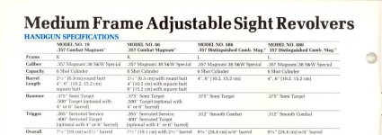

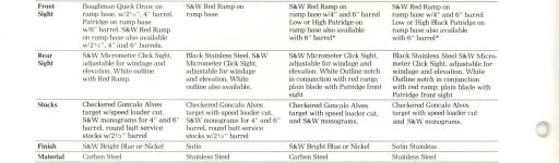

Does anyone know how long the stainless rear adjustable sights were manufactured after S&W first came out with stainless revolvers? The model 66 no dash in particular.
I know It didn't take long for S&W to decide they were too hard on the tooling to manufacture and replaced them with blued rear sights.
The sights were actually replaced because stainless front/rear sights were too hard to see in bright sunlight.
LEOs hated them
It was probably some time in late 1973 or early 1974 that the Factory returned to the black rear sight
Smith & Wesson wastes nothing so once the black sights started shipping, stainless still trickled out. After all they were not going to throw away all of those sight assemblies
You will also find Revolvers from those first few years that had the stainless sight blade replaced with a black one for the improved sight picture.
It was late in 1975, same time as they introduced the 2.5" version.
...they were too hard on the tooling to manufacture and replaced them with blued rear sights.
Although they were black and not silver, they were still made of stainless steel.
(page from 1982 catalog, first one I opened)
