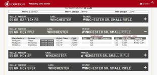

Go to the Hodgdon online loading data. Select Rifle, 223 Remington, then filter for 55gr bullets. Scroll down to "55GR HDY FMJ". I have seen pistol powders used for "mousefart" loads in rifles before but I think these are guaranteed squibs.

Is that load for a .223/5.56 case, or something much smaller that uses that bullet? They look like pistol loads and pistol powders, with velocities out of ~7" barrel, but I don't think I'd trust that tiny amount of powder in such a relatively big case as .223. My spidey sense says good chance of a flashover pressure spike.
Google - hodgdon subsonic loads
That's probably it. However:
Some data is shown that is subsonic. These loads are noted as subsonic.
So the typo is the omission of the subsonic tag. Interesting to note that the printed version of the manual does not list any subsonic loadings for 223. Thread title edited to be less theatrical.

The data listed by Hodgdon only states a 24" barrel was used , no mention of a suppressor ... the test were probably done in a bolt action with no supressor ...
Hornady tested the bullets and loads in a 26" barreled Remington model 700 ... I like it when they publish what firearm and barrel length is used to work up the data they give .

It's nice that they show the options... The case capacity is about the same as a .357 Mag. so it seems like the loads are very, very light but it looks like they were trying to stay subsonic.
