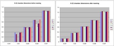

Here's a graph that I made of the chamber diameters at different depths of a K-22 cylinder when I went waaay overboard measuring things during my first experience with rimfire chamber reaming.
As others have mentioned, I use a .25 caliber brush for cleaning rimfire chambers.
