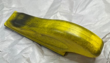

The block sanding is going slowly, but making for decent results.
I swear this gun was hit with both a wire wheel and flap disc for some reason. Some sacrificial screws were placed to secure the side plate during sanding.
Alternating between 100-120 grit, then blending with 220. Trying to keep everything square, don’t want to dish it out.

I tried 80 grit paper for the first time yesterday and it made very fast work of the larger pits on my project. What sanding block are you using? The one I have works ok, but I'm always on the lookout for new tools.
