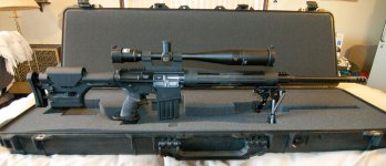

I got bit by that bug a few years ago:
Yes, non conventional as far as type, but it shoots as well as a Model 70 Target my father once used in at 1,000 yard matches at Camp Perry - at least at 100 yards.
I don't have a long distance range near by to try it out at. Base rifle is DPMS in .308 caliber. Here's a comparison shot with a standard AR15:
Definitely NOT something I would want to drag through the woods though because it tips the scales at around 12 pounds. :(
