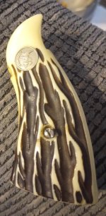

I can't imagine furnishing large quantities of actual jigged bone grips, the picture with the missile in the background the grips are clearly the "miracle material" Franzite. The dark markings even match a set I have in my orphan grip and holster box.
Kwill is correct. The photos of the silvery looking revolvers in use by the Elite Guard were, in fact, refurbished Victory Model guns, not nickel Model 15s.
And those Victory Model revolvers were not nickel plated. They were chromed. That information comes from the April 11, 1961 Authorization For Special Uniform Items provided to the Commander of the 3902nd Combat Defense Squadron at Offutt AFB. The same document stated that "Grips, Stag, Plastic" were to be used on the .38 revolvers. A later document, which I recall but cannot locate at the moment, specifically called for Franzite brand grips. The aforementioned Authorization also called for cross draw holsters for 4 inch barrel revolvers.

I actually have a pair of those Franzite stag grips sitting around. Never knew they had a possible military connection.
