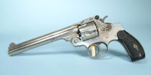

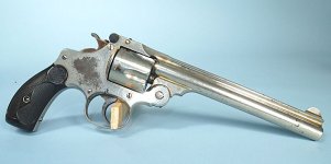

Hi, I'm new member to the S&W Forum, but have lurked and obtained tons of great info over the years. Thanks to all in advance!
I have the opportunity to purchase a .32 Top Break, 6-6.5", nickel, black S&W stocks, and it is labeled as a "5th Model". The unusual (to me) feature is that it has a side latch like a swing-out cylinder model would have. Also, it is obviously a .32, but the caliber is not marked anywhere; barrel sides, frame, nada. Has cylinder locking slots like a modern revolver.
The cylinder is snug (doesn't quite spin on its own), timing is good. Bore looks like it was a bit rusted and brushed out - so micro-pits throughout, but fairly decent rifling intact. exterior has lots of tiny rust spots but about 80% of plating is intact
Sorry I didn't get to take any photos, but I presumed that a Top Break with a side latch would be unusual enough to zero in on the model. Any info would be welcome. Thanks!

There seems to be some confusion here. The only revolver that S&W ever made that was a Top Break with a side latch was the 38 Double Action Perfected model. Not the same as the 38 Double Action 5th Model. The Perfected was built on a completely redesigned frame, completely different than the 38 Double Action models 1st through 5th models.
This is a photo of a 38 Double Action 3rd model. It is very similar to the 38 Double Action 5th model. Note the trigger guard is a separate piece attached to the frame. Note the side plate is on the left side of the gun.
The 38 Double Action Perfected model was only chambered for 38 S&W, not 38 Special. It was not chambered for any 32 caliber cartridge. The frame and the internal mechanism were completely different than the earlier 38 Double Action models. In addition to having the thumb latch, the trigger guard was integral to the frame and the side plate was on the right side of the gun. Standard barrel lengths were 3 1/4", 4", 5", and 6".
Yes, you must push the thumb piece forward and lift the top latch simultaneously to open one. Just operating one or the other independently will not open the gun. Anyone who says otherwise doesn't know what he is talking about. The idea was that if a bad guy had a standard Top Break pointed at him he could reach forward and disable the gun by lifting up the top latch. That's why the Perfected had the thumb latch. You have to work them both at once to open the gun.

The piece in question is the Perfected model, 38 S&W, 6" barrel. I may have been generous in my original assessment of the nickel, but it still looks like a reasonably serviceable revolver for what I paid.

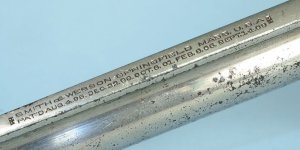

33XXX would be pre-hammer block safety, but you might be interested in reading about these guns. http://smith-wessonforum.com/blog.php?b=109

The Perfected model was made from 1909 until 1920. Serial numbers ran from 1 through 59,400.
My blue one has a SN of 99XX and it shipped in 1912. My nickel plated one has a SN of 552XX and it shipped in 1917. Of course you can't assume anything with S&W, but I'll bet the one you are looking at shipped somewhere in the middle of that.

Picked up a 6" a few years ago, but I think it was the only long barrel Perfected I have had a chance to buy. Some call the 6" rare, but I suspect they put as many on their Perfected revolvers as they put on their 38 Double Actions, maybe 10%. Both models used the same barrel. As stated above the truly rare example of a Perfected was made without the thumb latch.
My 6" came with a set of target stocks that fit very well to the gun. Roy Jinks made a comment that even though these revolvers had standard forged sights, they were popular target guns in Europe and South America and target stocks could have been added to any purchase for a small price. Mine is what I call a 38 Perfected, 1st Change since it has the late in production hammer block with 1914 patent stamp on the barrel. These are somewhat scarce, since less than 2000 out of the 57,500 total were made. As for the ultra-rare Perfected, I have an image of one example. No latch and 6" barrel definitely qualifies as rare.
