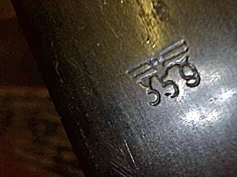

Here is an example where I fiddled around with contrast and other settings. First is pretty much as the naked eye would see it; second is after fiddling with settings. Both done on an i-phone . The number is 101 with a 'J' above it. I have seen several others with the J too, but not too many.

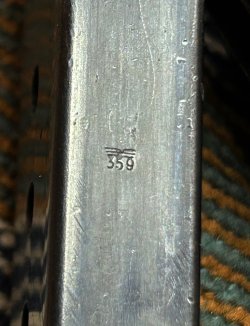

Here are my tips. This is a p38 magazine with a tiny WaA, hard to read:
Here it is zoomed with an i-phone. I touch the screen where the WaA stamp is to get the focus.
Here it is with photo software cropped and zoomed :
For hard to reach and photograph areas, I use my borescope, which is TESLONG attachment to my iPhone. Great for reading lug areas. Bear in mind this WaA is maybe 3/16th of an inch.
