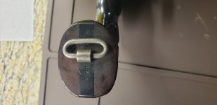

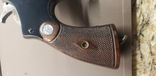

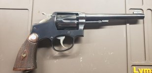

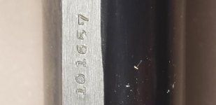

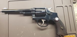

I recently acquired a S&W 32-20 ctg from my Uncle. Was wondering how to identify the year and value of the firearm.
The serial number is 101657

The star on the butt tells us it went back to the mother ship for some work, probably a refinish. Check under the grips, left side, for a date in this form 4.52 (April 1952) or some such. The grips should have the SN stamped on them too if original to the gun. They're from the 1930s (small silver medallion) and the SN is likely mid '30s. Looks to be in very good condition. Value, as a factory refinished example, maybe $500-$600 where I shop. The 32-20s are fun guns to shoot although ammo isn't widely available and is fairly expensive when found. Welcome to the Forum.

Welcome to the forum from the Colorado Front Range sir! Can't help with the info you're looking for but very nice looking revolver. The folks who will post next will have more info but for value they will also ask that you remove the grips and see if the same serial number on the frame matches that on I believe, the inside of the right grip. Believe the star preceding the serial number on the bottom of the grip frame indicates rework of some kind at the factory so pictures showing both sides of the grip frame that clearly show marking will also help them/you out. The added swivel obscuring the serial number isn't original and was probably added by a local gunsmith.
Good catch, although the butt swivel may be factory work, might be part of the reason for the star stamp. If the factory did install it, and drilled a hole through the serial number, the frame will be stamped with the SN on the left side. A non factory gunsmith might do that too. If there is no SN stamp on the side of the frame and if the hole for the swivel obliterates the SN that is technically an issue with the ATF although not that big a deal from my perspective. The SN can also be found on the back of the cylinder and on the barrel, and a couple other harder to find places.

Based on the serial number and the lack of Made in U.S.A. on the frame, this revolver is almost certainly from about 1921.
However, the barrel and extractor rod are from later than that, as are the stocks. I suspect it went back to the Service Department at the factory sometime after 1930. The extractor was changed, probably the barrel also and the stocks. The fact that the serial number appears on the barrel flat is another indication that the work was done at Springfield.

Added: I forgot to mention the swivel. It clearly was added later. The fact that it splits the serial number is suspicious. If the factory did that, they would have restamped the serial number on the side of the grip frame. That is another thing to look for when you remove the stocks.

Welcome to the Forum. The barrel raises some questions as to its originality as well as the other subjects covered above. The caliber marking for these guns from 1914 until 1922 was 32 W C.F. CTG on right side of barrel changed to 32-20 between serial numbers 111,000 & 113,000 starting around 1923. The front sight is pinned for some reason which was not the practice for standard revolvers which had forged front sights. Maybe the barrel was replaced post-WWI and target barrels were all that was left in the factory?? This caliber was phased out in the 1930s. Lastly, the serial number stamping on the barrel flat does not look like a factory stamping?? Interesting gun, but the factory rework did you no favors as far as collectability goes.
If you were to sell the gun, expect to get less than $500 for it, maybe much less.
