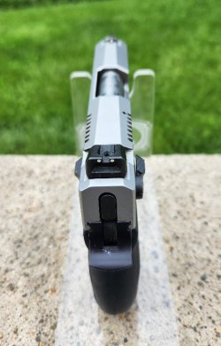

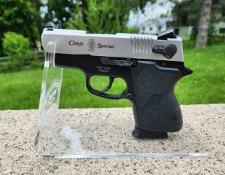

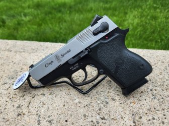

I purchased this on GB this week. Credit to the FFL there. He shipped it the day after the sale, CA to CT. My FFL received it Thursday; I picked it up this morning. Price was good too. $496.28 total after fees, shipping and tax.
Question for those knowledgeable in the CS series. I also have my eye on a CS9D in stainless. I've heard those are hard to come by. Is that true?
