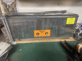

Always read the label for ingredients of the solvent used in the ultrasonic. Phosphoric acid is bad for steel, it will remove the blue, Sodium hydroxide is bad for aluminum parts, it will remove the anodize finish and etch polished parts. Ask me how I know? You almost need two different ultrasonic cleaners. I use a sodium hydroxide based engine cleaner I get from AutoZone in my ultrasonic cleaner for steel parts but lesson learned, I don't put aluminum framed firearms in it. Aluminum framed guns/parts get the brake cleaner and tooth brush treatment.I would not use vinegar on any firearm.

The hardest part is getting ok with throwing your gun in the water.
