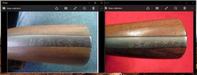

Hello my fellow enthusiasts!
I've had a Victory model stashed away for a few years that I picked up at a local auction house in SoCal. I had meant to post about it after receiving it but life got complicated and that task became a low priority. I probably paid too much for it but I had to have it because it had "PROPERTY USMC" marked on the left side of it. I'm a retired Marine and having something marked USMC is kind of neat.
Even though I have several other Victory's in various markings from U.S. Navy, U.S. Government, etc. from original finishes to refinished I don't consider myself a connoisseur of them. I simply buy them if I find them at a reasonable price, each time hoping I get something more unique than the previous one.
That said, somewhere in the back of my mind I thought I have seen where the USMC may not actually mean United States Marine Corps but something else. It does have U.S. Navy marked on the top strap. I'm sure someone here can quickly straighten me out.
Regardless, I still like the USMC markings on it.
On another note, for those that are history/firearm/USMC buffs does anyone know if the Marine pilots actually carried Victories in the cockpit and if so what the markings were? U.S. Navy if not USMC?
Cool gun! I have seen a post here about a similar gun and seem to recall the stamping stands for US Maritime Commission but one of the real experts like kwill1911 will be along with more information.
I think USMC aviators during WW II would have had US Navy stamped guns, or later in the war generically stamped ones.
After seeing US Maritime Commission in print from you I think it might have been one of the old guys at the auction house that suggested that to me when he asked why I was set on outbidding everyone to win this particular firearm. Of course that could have been harassment as well (lol). I look forward to hearing from kwill1911 if he comes along. Thanks for the memory jolt.
After seeing US Maritime Commission in print from you I think it might have been one of the old guys at the auction house that suggested that to me when he asked why I was set on outbidding everyone to win this particular firearm. Of course that could have been harassment as well (lol). I look forward to hearing from kwill1911 if comes along. Thanks for the memory jolt.

To get an honest to goodness Marine firearm, let me suggest a Remington 40X SB that is marked Property of the USMC and they really were. The CMP sold these a few years back for around $800. Most had badly scratched bbls, but they were genuine Marine issue starting around 1958. They only made 2687 of the Marine marked rifles in two orders. Last nice one I saw for sale brought $2,500. Army ones do not bring that kind of $$$. Semper Fi. Big Larry
With the US NAVY topstrap stamp, we can pretty much eliminate the Maritime Commission, unless that stamp is fake, which it does not look like.
Marine aviators did indeed carry Navy-procured guns. However, no general markings denoting the Corps are known; Charles Pate in his book lists the PROPERTY USMC as a possible fake stamp, apparently because he had an example where it showed up on a gun that lettered as shipped to Ford Motor Co., so it was originally an unmarked DSC contract gun, non-military with the stamp added later by parties unknown.
Your Navy stamp makes that a bit less likely, but is not proof of authenticity.
That is very interesting. So a step towards authenticity would be a letter to see if it was indeed a U.S. Navy firearm. However, that doesn't guarantee that someone just didn't slap on the PROPERTY USMC at a later time during its lifetime. I have added a close up picture of the USMC markings.
S/N V408987 is said to have been issued to Major Gregory "Pappy" Boington, USMC. Think everyone has heard of him.
I have seen Colt Official Police and Commandos USMC marked and lettered as delivered to the Marines. Tough to find one for sale because you bellhops hoard them.
A Victory with a PROPERTY USMC stamping or engraving would be very suspicious to any collector as to its originality, lacking any proof to the contrary. The U.S. NAVY topstrap stamping would be believable as the revolver is in the correct SN range. And it would not be a U. S. Maritime Commission gun.

Kevcon, You need to letter your Victory. Any Victory model acquired in a So.Cal auction ( located a short distance from the source of 99% of fake Victory Models ) , with a USMC stamp is very suspect. As a side note, legend has it that genuine United States Maritime Commission Victory models are marked with decimal marks between the letters ( U.S.M.C. ) This is based on Victory Models found in the Arms Lockers of WW2 Liberty ships being scrapped at Benecia, CA., in the 1950s. Ed.
.... legend has it that genuine United States Maritime Commission Victory models are marked with decimal marks between the letters ( U.S.M.C. ) This is based on Victory Models found in the Arms Lockers of WW2 Liberty ships being scrapped at Benecia, CA., in the 1950s. Ed.
That is very interesting. I hadn't heard about this before. The lettered U.S.M.C. guns I've owned and seen all had no stampings of any kind.
But a few marked guns have shown up here and in other forums over the past years which to my knowledge have not been authenticated or explained. See attached.

Although I can't attest to the authenticity of the markings, what I can tell you is, that's one cool Victory model that I'd love to own. :cool: And I can also tell you it most likely shipped in September of 1942. Nice score! ;)

I am curious were I can find what some of the proof stampings under the right side grip on the frame represent. Particularly the "D8", "J", "G" (or could that be "GC"?) and the "O". It looks like the grips match the frame....maybe? The grips appear to be marked 888 and the frame is 883...maybe the 3 punched out as an 8 or the marker got lazy?

The only Victory Models I've seen with definite proof stamps were some in the V400-500000 range, with a small P on the left upper rear frame just forward from and above the hammer.
I have one such marked Victory, V548xxx, that also has the flaming bomb forward of the lanyard loop. Probably a DSC guard gun but going to letter it anyway on the off chance it was shipped to somewhere of historical note. Have a 1911 shipped to the Adjutant General, State of New York in 1914, that was a surprise.
Alan:
This isn't just a matter of "some". Pretty much all early military pre-Victorys and Victorys from a certain date on got the P proof on the butt. At a point in 1943/44 sometime, this moved to the triple P proof on the frame as you describe as well as underbarrel flat and cylinder face. From that time on, ALL Victorys, BSR or US version, military or DSC, received those three P proofs, which were applied by ordnance contractors at the factory. Of course, as always, some individual guns may show some variance.
I have Victory V419221 that letters to the U.S. Maritime Commission shipped Jan.13,1944 to Reading, PA. Gun has no military mkgs on topstrap but has the flaming bomb on butt. Also has the "P" on barrel, cylinder and top of left frame. Ron
