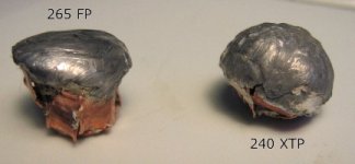

Here is some pics from the old test into paper.
IME, the final appearance of the bullet is not important, it's just the tool. The wound cavity is the job.
Don't get stuck on weight retention or expanded diameter.
Depth and volume of the wound cavity are what matters.
Did it deliver?
Also IME, a cast lead bullet does not need much to get busy expanding. smaller, shallower point cavities with some flare seem to get things started quite well. Once started, cast lead keeps at it till the energy is spent. Don't expect them to retain weight like a JHP. It simply can't. it's just something you need to accept

AFA those Ness Hollowpoints are concerned...
According to what I can find, i.e., the HG #38 Ness Safety Hollowpoint casts (per MP Molds) as 150gr in 0.311"... That couldn't be a 9mm bullet in the images!
Can't imagine how a design like that could be used in 9mm: could never get them to feed or even fit in a magazine. The Federal 38 Special +P 135gr HST Micro needs to be loaded as a wadcutter (or, close to one), and that's in much longer 38 Special or 357 Magnum brass...
