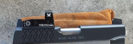

If you don't like co-witnessing your iron sights, then a mount that uses the rear sight dovetail makes sense. Cheaper too. I have a RIA 1911 with such a set up using the factory Burris Fastfire lll rear sight dovetail mount, and it works fine. Just picked up a Kimber 1911 with the factory mounted Venom using a milled mounting plate with a tall rear sight built in to the mount itself. I like the co-witness, at least on a gun that might be carried for self defense.
Larry
