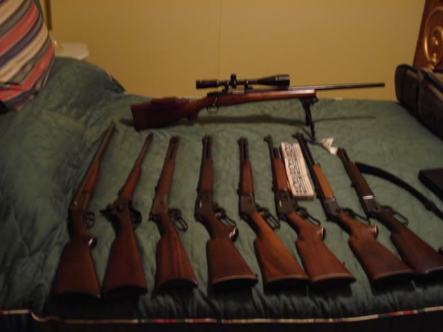

a tool is no better than the guy using it, in the picture below there is a pre 64 win model 70 target setting across the the top of the bed
http://i269.photobucket.com/albums/jj55/kywonder/DSC00108.jpg?t=1261880829 this rifle is capable of shooting micky mouse ears ( Three shot group all touching) at 100 yards, but then again so is the out of the box savage

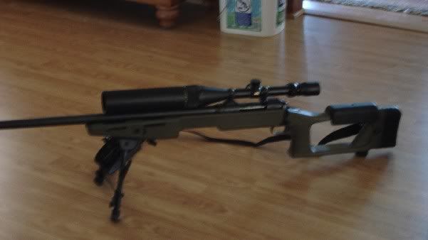

tactical with the accu trigger system, pictured below.
http://i269.photobucket.com/albums/jj55/kywonder/now003.jpg?t=1261881256
the biggest varible is the shooter, my definition of a accurate rifle , is one that consistantly places the rounds down range to the same point of aim if all other varibles are the same.
