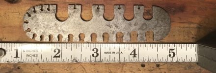

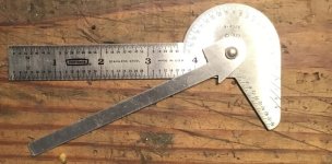

What are these?
First one looks like a sparkplug gap tool. I've got a couple similar to the second one that I use.
Gee, was going to let some young guys take a gander at them and guess…
Sorry. I did not know that us old farts that used these tools shouldn't answer. LOL

A table fork does a fine job of measuring pi. Just did it this morning with a cherry version and coffee. No pi survived the exercise. The "protractor" would do a fine job of cutting rafters if'n you don't want to use a framing square, and possibly more accurate for the initiated.
