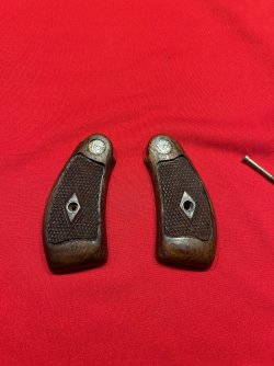

I picked up these grips and I would like to find a gun that fits them. I am told they fit round butt K frames. Can't quite make out the number stamped on them but it looks like 294604. The first number is difficult to read. I don't own any round butt K frames but I would like to pick up something interesting. Any suggestions for model and time period? I tend to like target guns. IMG_7889.jpg
It is hard for me to tell what they fit without any reference for the 'size'.
Pictures with a ruler, front and back would help me figure it out. Perhaps others can make an educated guess without more information.
I was thinking they are for a Baby Chiefs Special or an early Terrier (which are the same), but this thread made me get out my early Baby Chiefs and a ruler. Results below. The OP stocks are a bit larger, so not a Baby Chiefs or Terrier. The larger Chiefs and Terrier stocks to my knowledge were Magna style, not Service stocks....Baby Chiefs Stocks.jpgBaby Chiefs Stocks.jpg
They look like they might be magnas converted to early post-war service stocks. Is there a steel washer on the back? I'm leaning toward that being the case. If not, they're fairly scarce. I have a twin to the one in post #3 with the post-war non magna K service stocks.
Yes, they have steel washers in the back.
