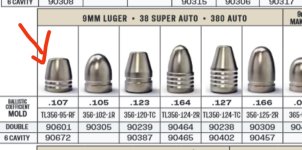

Lee makes this, if you are going to cast your bullets
I see Lee offers a 95 grain mold in an RNFP.
That is a very good design. It acts like a little wad cutter. Only thing - if your gun has a steep feed ramp you need to cast them hard or they can deform, causing feeding problems.
Otherwise, that is an inherently accurate boolit.
