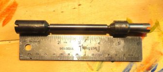

Lee Barner US Veteran Gold Supporter Joined Feb 16, 2005 Messages 4,078 Reaction score 17,366 Location Springfield, MO Jan 11, 2025 #1 found it in a parts drawer and can't remember what it is used for. maybe something to do with 1911s? thanks in advance. Lee Attachments IMG_2217.jpg 73.1 KB · Views: 213 IMG_2216.jpg 70.3 KB · Views: 235

J jem102 Silver Supporter Joined Jun 13, 2021 Messages 613 Reaction score 663 Location East TN Jan 11, 2025 #2 A mandrel for holding a barrel to apply the markings, engine turning or other such process?
oldbrownhat Silver Supporter Joined Dec 11, 2008 Messages 7,211 Reaction score 22,318 Location Pacific North-Wet Jan 11, 2025 #3 jem102 said: A mandrel for holding a barrel to apply the markings, engine turning or other such process? Click to expand... That'd be a fair guess. Presumably other inserts were available for longer barrels. That one appears to be about 2 1/2".
A alwslate Gold Supporter Joined Dec 24, 2009 Messages 7,373 Reaction score 8,632 Location Indiana Jan 11, 2025 #4 The piece on the right end looks to be hardened. Possibly a home made tool to true up a short barrel forcing cone.
W WR Moore Bronze Supporter Joined Oct 17, 2006 Messages 7,735 Reaction score 7,117 Jan 11, 2025 #5 Looks like a mandrel for making bushings.
J jjrr US Veteran Joined Dec 8, 2019 Messages 257 Reaction score 294 Jan 13, 2025 #6 Looks like some carburetor adjusting tool from days gone by. The ones I have have a flexible shaft.
PatriotX Gold Supporter Joined Mar 5, 2014 Messages 4,062 Reaction score 11,026 Location Midwest Jan 13, 2025 #7 Barrel bushing fitting mandrel Barrel Bushing Fitting Mandrel for 1911-BDA48375
