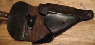

So if I am looking for a holster to carry it in, something like this would be age appropriate? (There's a military type match I'm looking at competing in).
Yes, that looks more like it. It should also attach easier to a belt without a conversion. The Flecktarn holster attaches to the German military belt and does not use a loop.
Both holsters are definitely not built for speed!
Speed is apparently in the eye of the beerholder :D
It did offer a slight speed improvement compared to the AKAH style that required you to fold and hold various leather flaps out of the way, like this post-war East German version:
