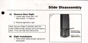

For my M&P9c, it was 1/16 for the rear sight. Make sure you use imperial inches because there is no metric equivalent that will exactly fit it.

1/16" is the correct size but be careful and don't strip the nut.
A Bondhus brand 1/16" L wrench fits my Pro set screw about as good as it gets.
