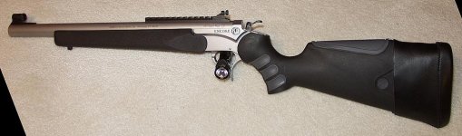

Since my first .445SM rounds were made from rifle brass, I started using the large rifle primers right away.
Since then I have trimmed down all the Starline .445 primer pockets to accept them.
They work fine in the Dan Wesson and also the Encores.
Once you get up to (and above) magnum pressures, there is very little to no unburnt powder with 4227.
Some ash maybe but no granules.
