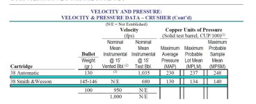

According to SAAMI the .38 S&W and its 146 grain bullet at 680 develop
a mean pressure of 13,400 CUP or 5.9tsi
I believe the British service cartridge is a bit more energetic at 176 ft/lbs than the .38 S&W at 152.
