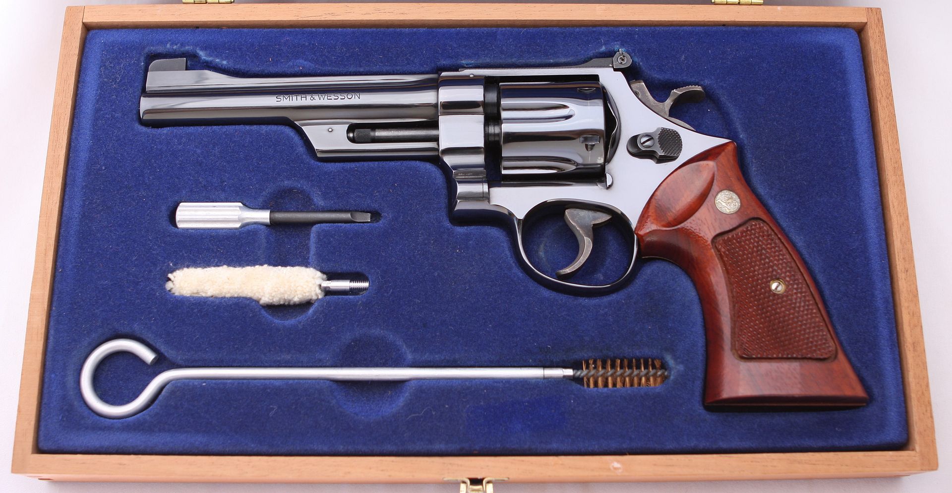

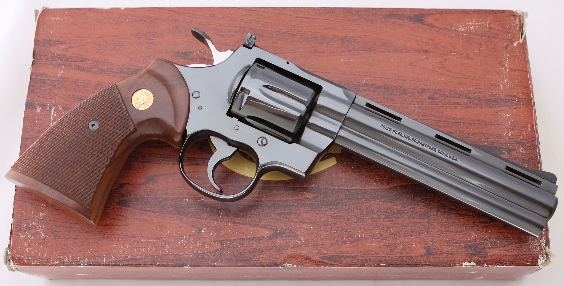

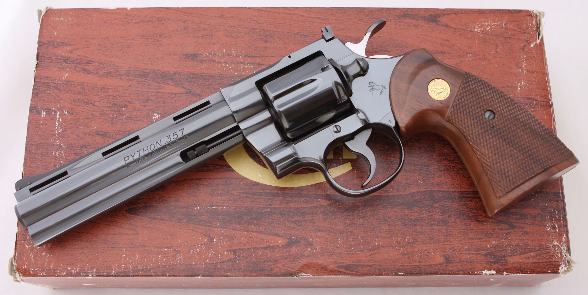

When comparing, you have to compare top of the line with top of the line. That would be the Model 27 with the Python.
6" 27-2
6" Python:
Yes, I know that the Python frame and full underlug are more like the 586 and 686 L frames, but for the pre-1982 era, it would have been comparing the Model 27 with the Python. They are Both great guns - classic revolvers. I have no experience shooting the Pythons, and I have heard that they are a bit more temperamental in getting the trigger pull just right, but they sure are pretty guns. I HAVE shot many many Model 27s (and their predecessors). They are my favorite S&W Magnum and I have some with outstanding triggers - I love them.:):cool:
