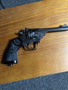

I don't know why we adopted some cartridges, but didn't adopt others. I do have a .455 MKVI Webley though. I load 230 grain .45 ACP and Auto Rim for the Webley to approx. 700 FPS. I also have one of those spacer rings, so I can shoot the original .455 ammunition. Recoil with both types of ammunition is pretty soft. The Fiocchi 265 grain factory ammo averaged only 554 FPS in my Webley.
I haven't attempted to load the .455" hollow base bullets many Webley owners have mentioned. The chamber throats of my Webley are .450". And if the rifling is .004", as I have read, the barrel groove diameter is ~.450" too. The old gun shoots pretty close to POA at 15 yards using .452" cast bullets or .451" plated bullets...
