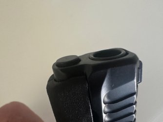

Why does my recoil rod stick out so far on my BG 2.0?
If the spring cap is threaded into the inner rod, why would it NOT be fully seated at the end of the inner rod.
If the end cap is not fully seated, it is not normal.
That spring cap that is extended a few thousandths beyond the end of the slide is not a "standoff device".
I am concerned that it may be unscrewing from the inner rod.

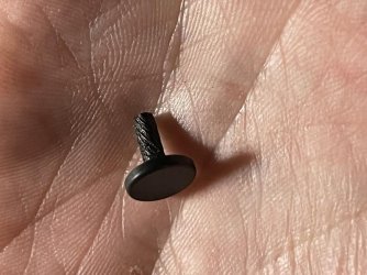

To add to the confusion, I don’t think the retainer/cap on a BG2.0 recoil spring assy is threaded.
I’ve haven’t taken my BG2.0 recoil spring assy apart, but from a photo posted by Wheelin89 in thread https://smith-wessonforum.com/threads/bodyguard-2-0-guide-rod-recoil-spring.727095/post-142114216 , it looks like the retainer/cap is a press fit and not threaded like other M&P's.
It looks like a spiral knurled pin for press fitting.
So, this raises the issue of how much less than fully seated is acceptable? Last year I had called S&W about a 4" Shield Plus recoil spring retainer that had unscrewed about 1/16 of an inch. They said that shouldn't have happened and sent me a new spring assy.
Wow... I don't remember seeing that photo of the rod cap!!
Now I'm very concerned with that design.
This is another issue for me adding to the list regarding S&W's engineering designs.
One.... is there enough friction in that very short pressed-in knurled area to keep the rod cap from moving or popping off?
Two.... is the level of quality control questionable?
Three... why would S&W opt to NOT use a threaded end cap on a highly stressed guide rod spring assembly?

I used my end cap as a push off device to open a wooden door in a barricade while maintaining a two hand firing grip on the gun during an IDPA match that I shot with the BG 2.0 today. No problem, and the gun even worked for the rest of the match and is sitting at home loaded with carry ammo.
Here's the second one from S&W. Same result. I just don't understand why they would design a pistol like this...
