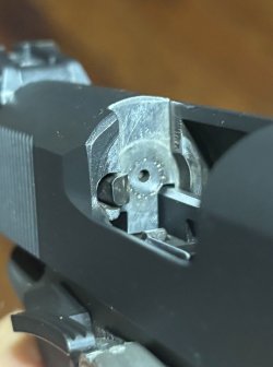

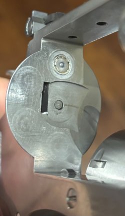

I have 2 guns in 10 mm, a 610-2 and a RIA 1911. Took them to range last week and the 610 cylinder was jamming between shots. Would have to give it a smack with a hard plastic ammo box to unlatch cylinder then it would go back in and rotate normally. Noticed about 5-6 dark primers. The 1911 shot normal-no issues with it. When I got home and was cleaning the guns saw the damage to breech face on both guns, but the 1911 may have been there for a while.
Checked the primers, they have a tiny crack in the bottom of the pin indention. Did not save any or get pictures. I am running 8.4 gr of Power Pistol over Remington 2 1/2 large primers with a 180 gr plated flat tip bullet. My Garmin was clocking the bullet at 1,150 FPS out of the 4 inch barrel 610 and 1,160 out of the 5 inch barrel 1911.
I assume the 610 was "spot welding" the primer base to the recoil shield, but seeing as this load is almost a full grain below max, not sure why this is happening?RIA.jpg610.jpg

First, you mention that the primers have a tiny crack in the pin indent. Check your firing pins, the ends are supposed to be round, without sharp points. If you've got a crack in the primer indent, you have gas leakage that's eroding the breech face. May be a defect in the primer cup material that's allowing perforation of the cup. Just as a start, if your pin noses are properly shaped, you should try another brand of primer. I've used that same load (varies a bit 8.22-8.4 gr) with WWLPs and XTPs without issue.
Also, just because the load data is safe in the load manual doesn't mean it's safe in your particular gun. Those case head markings on the recoil shield suggest things aren't business as usual. My 70's era model 28 doesn't have marking like that.

The firing pin bushing in the 610 is damaged but it can be replaced. The damage seems unusual for a "hot" load; if you're piercing primers the damage should be to the tip of the firing pin and the inner part of the bushing. Is it possible that the bushing had been protruding too far and was interfering with the rotation of the cylinder?
If the bushing is interfering with the cylinder rotation, its only doing it after the shell has been fired. Rotates normally with unfired bullets in place, I cannot feel the bushing protruding with my finger, and I lightly ran a file across it to see if it catches any material and it seems flush or slightly recessed. I agree about the damage being too far out in diameter on both guns to seem to be from pierced primers but what else could cause that type of damage?

Both guns show significant damage from erosion of gas leaking around the primers. This is different than piercing a primer on the center at the firing pin indent. To have gas leakage around the perimeter of the primer means something is wrong and there is too much gas pressure for the primer cup to contain.
Whether the damage is from prior loads you have shot or is from your current recipe, I can't tell from my keyboard, but you need to take a careful look at your recently fired brass. Whatever ammo you shot that caused the damage in both guns I'm betting has black soot around the primers and signs of gas leakage.
In whatever ammo caused those problems (and it looks like you shot plenty of it in both guns) there is something wrong in your combination of cases, primers, or powder that is causing the high pressure gas leakage.
The cylinder binding in the 610 is certainly due to your primer flowing into those erosion caused voids in the firing pin bushing. Take a careful look at your fired brass. I bet you will see asperities in the primer surface that interfered with your cylinder rotation.

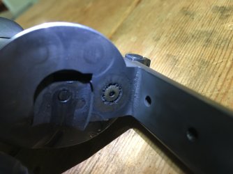

Hi OP I’m glad you got this sorted out. Back in 2016 I ran into a similar problem with 44 magnum loads. I discovered a badly eroded firing pin bushing on my 629.
As you can see the damage looked pretty bad. I did two things to fix the issue.
First I shipped the gun to Smith and Wesson for repair. They replaced the bushing and firing pin. They did so free of charge.
Then I gathered up all of my 44 magnum brass and pulled the few remaining loaded rounds I had. I chucked it all in the garbage. I ordered 1000 brand new cases from starline, and I’ve never had a problem since.
