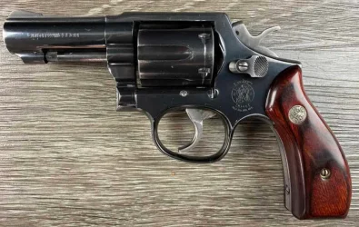

Why would Bubba do this??
Pre-war S&Ws used threaded studs (at least the hammer). Post-war they started to use press fit studs. They are very difficult to replace outside of the factory.

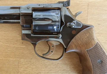

Here’s a pic of an old Mulhouse built Manurhin MR73. Everyone knows that these were designed to be more rugged versions of a S&W. One thing they did was to use specially hardened studs. When the gun was blued, the result was a color difference because of the two different steels.
Unless we know the specific history of the revolver in the original post, we can’t say for sure that the work isn’t actually an improvement! Likely the original stud broke. Perhaps somebody engineered an improvement and just left the part “in the white”?
Having said that, I agree that the closing price on this one seems perhaps ridiculous.
