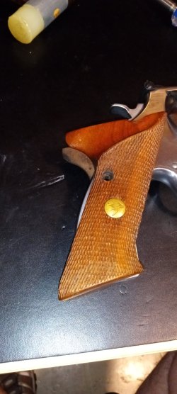

My son just picked up a 27, #N167XXX, and when he pulled the grips, this is what he found..... They are NOT Target grips, but just the grips the fit on each side of the frame, with the a serial number showing. Would that vintage 27 be shipped with Target grips. Looking for some info and help... THANKS....FlyingliverIMG_4567.png
Model 27s could have shipped with either magna style grips, which is what you describe, or optional target grips. The serial number on yours are later than the gun, so they are likely replacements. Perhaps at sometimes in its life it had rubber grips on and somebody chose to replace him with a set of magna grips. At that point the original grips were likely long gone. If the grips fit correctly, they are most likely N frame grips.
Thanks for the info... I figured that the N frame was larger in the grip area. The gun shop had two 27's that came in from the same consigner and he'll check the serial on the other one tomorrow. They may have been inadvertently switched.
My son just picked up a 27, #N167XXX, and when he pulled the grips, this is what he found..... They are NOT Target grips, but just the grips the fit on each side of the frame, with the a serial number showing. Would that vintage 27 be shipped with Target grips. Looking for some info and help... THANKS....FlyingliverView attachment 761098
You are describing Magna grips. Those were the standard grips for the M27 until 1974 or so, Targets were optional. Unlike the M29 where the Target were standard grips due to the 44 magnum and the need to hold onto more wood.
Your son's gun was made in 1973, so it could have come with Magna grips. Post a pic of the current grips and we will tell you if they are period correct. The ones above are not original to the gun but could be exactly the same as what it came with.
