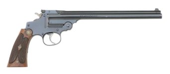

We shall have to wait and see once this March 1919 shipped Single Shot Perfected Third Model revolver I purchased earlier today has the logo on the left side or not. Stay tuned.
When this thread was started over ten years ago, the data situation was still quite a bit spottier than it is now.
There is no disagreement that logo stamping stopped in mid-1917 and resumed in early 1920.
Of course, stamping is concurrent with production, not shipping, so individual specimen showing a logo or no logo shipped outside those parameters are always possible.
