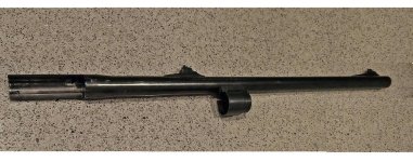

With a slug barrel, they come with adjustable rear sights and front sights, so accuracy is absolutely adequate out to 100 yards. Both 20 ga. Remington 1100 and 1187 can be fitted with a slug barrel. They can be found on ebay and other gun websites.
A typical 20 ga. slug weighs 280 grains, travels at 1500 fps, delivers 650 ft. lbs. @ 100 yards and will kill a deer easily out to that range. If you cannot get that close to a whitetail, might want to look for better hunting areas.
