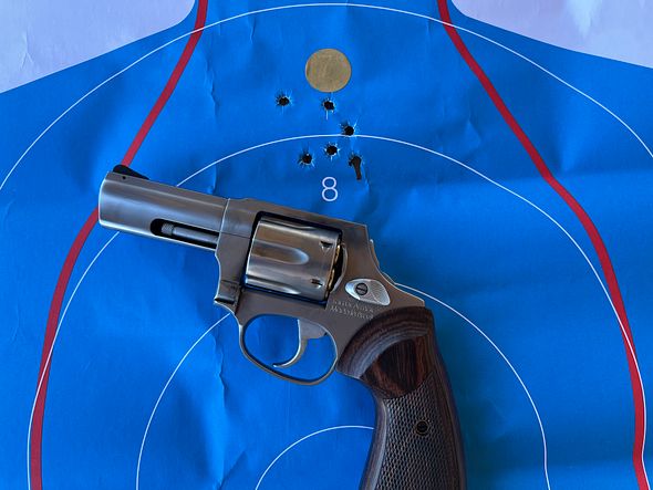

The 856 Executive shoots to point of aim with 158gr .38+P at 7 yards and demonstrated excellent DA rapid fire accuracy. This particular load uses a 158 gr LSWCHP, one that often doesn’t do well in longer .357 Magnum chambers.
It shoots a bit low with 125 gr .38+P.

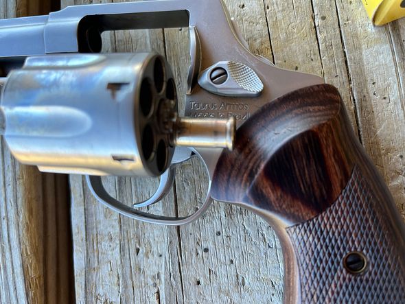

However, round speed loaders like the HKS “DS” which work well on the K6S and the regular rubber gripped 856 will not work at all with the grips on the Executive. The 5 Star speed loaders do however work quite well as does the Kimber branded speed loader for the K6S.
A more egregious problem with the Executive’s grips is the interference with the grip that occurs on ejection. It doesn’t happen all the time, but it happens a lot.
That’s unfortunate as the ejection is other wise excellent. While it could arguably have benefitted from a full length ejector rod, which is the norm on the slightly larger K frame sized 3” revolvers, the rounded end of the ejector rod doesn’t do a cookie cutter number on your palm with a Universal or Stress Fire reload, which is a plus.
To be fair, you’ll note neither of my $950-1000 K6S revolvers have their original grips either.
Still, the left grip panel is poorly designed for a revolver that is designed for self defense.

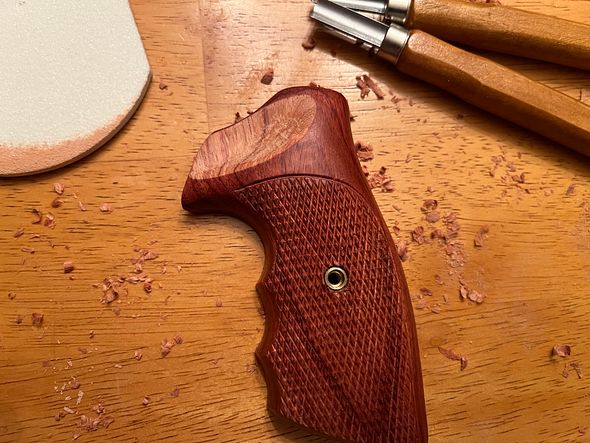

I made a couple changes.
The major issue I had with the 856 Executive was the grips. They slipped a bit in rapid fire making it a little harder to hold than it need to be, and one of the ejected cases would consistently hang up on the grip.
I tried a set of Pachmayer compact grips for a Model 85 but they didn’t fit. The screw location is higher and apparently is supposed to pass between the hammer spring and front strap. But it’s not quite high enough to clear the frame.

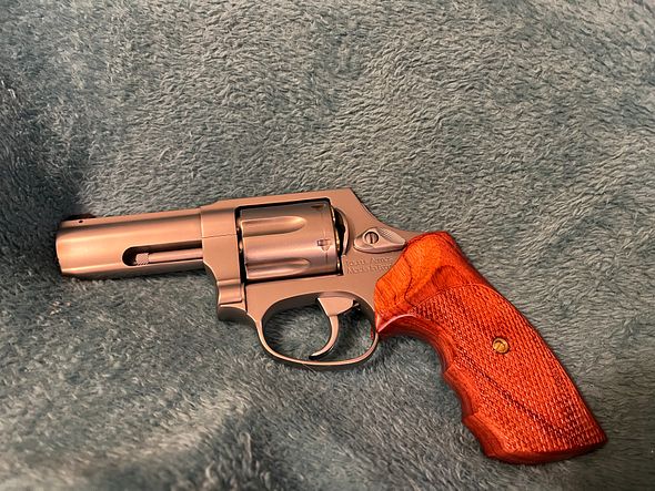

I purchased a set of checkered wood finger groove grips, and found they fit well and that that revolver pointed just as well with the new grips as it did with the old groups. The finger grooves also eliminate any slippage under recoil and make it much more comfortable to shoot.
However despite having hints of a cut for a speed loader, the cut proved to be cosmetic rather than functional.
However, I had anticipated that, and figured the contour would be a good place to start, just having to carve it deeper. That proved to be the case. It took a couple trial and error carving and fitting attempts to get adequate clearance for the speed loader.
It took another half dozen fits after making the curve of the cut progressively deeper each time before it would allow clean ejection of all the cases in any cylinder orientation.
I sanded the new cut smooth and finished it with a couple coats of pure Tung oil.
The color is just a bit lighter, more evident in white light, and less obvious is tungsten light. It’s close enough that I’m not going to worry about it. I’ll put a few more coats of oil on the speed loader cut over the next few days and call it good.
I also added a tritium front sight. I prefer to have tritium sights on my concealed carry handguns, even if it’s just the front sight. Provided the hand gun points well, a tritium front sight is sufficient for self defense purposes, particularly after you’ve shot it enough that your grip already aligns the rear sights with the front sight.
It’s the same sight Taurus puts on the 856 Defender, and it’s the same height as the sight that came on the Executive, so the point of impact didn’t change. It came pre drilled and was in fact a drop in fit, only requiring the roll pin to be drifted out to remove the old sight and drifted back in place to secure the new sight.
The bright orange front sight is useful in daylight and the tritium dot works well in low light, although it does raise the point of impact a few inches.
I’m now very pleased with it. Carrying it over the last several days it’s proved to be very comfortable in an IWB holder carried at 3:30. It has become my go to concealed carry revolver for any purpose where I don’t need a .357 Magnum.

The latest and last change was an all over refinish with Tru-oil. It has just enough tint to color match the old finish and I prefer an older school gloss finish.
