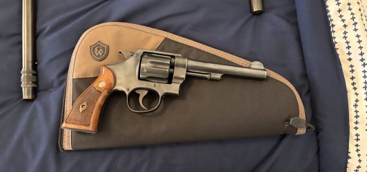

Hello all,
First timer here. Was looking for some wisdom on a M1917 I just recently was lucky enough to pick up. It appears to have all the correct markings of a military issue 1917, however the lanyard swivel is missing and the grips are not consistent with military issue. If I looked up the serial number correctly. It appears to have been manufactured in 1918.
My thinking is someone removed the lanyard swivel (I imagine this is relatively common among pistols that made it into civilian hands?) and put the more decorative grips on. But was wondering yalls thoughts on...
A) are these grips indeed original to the gun? (perhaps was never issued to military)
B) would it be worth it to purchase and install a lanyard swivel and original style grips or leave it as is as that is how it has lived most of its life? (I realize this is an opinion question but just curious to know the thoughts of people more knowledgeable on these things than I am)
C) Any other insight anyone may have on the pistol?
Would greatly appreciate any help!
-the_Riot
Great looking gun. If the finish is original (hard to tell, and I'm not an expert), it might then be worth it to restore the lanyard ring and original grips. But what's your intent for the gun? If it's a shooter, then it's great as is.
The lanyard ring is your personal preference. If you are planning to shoot it it might get in your way. If you are just putting it away in a collection you might want to put on on to make more original. Getting a decent pair of original stocks may be difficult. But you never know what might come up on E bay. If you are planning to shoot it, the current stocks are much better than the originals.
I am certianly not qualified to determine whether the finish is original either. But I do believe it is original based on the looks of it. It does have some wear around the flutes on the cylinder and some scratches here and there throughout, though mostly is in good condition.
I certainly intend for it to be a shooter. I've already got some moon clips on the way.
-the_Riot
-the_Riot
I wouldn't put money into a ring and grips then.
Welcome to the forums from the cotton and peanut covered plains of the Wiregrass! It appears the finish is satin nickel? If so, it is not original. Personally, I would not change anything on that one as it is in great shooter configuration with those sharp-shouldered magna grips as opposed to the military ones. The only thing better would be some target or combat grips.
As a shooter I would leave it as-is. I don’t know the current availability, but I’d think that at least replica but period-correct grips and lanyard loops could be fairly easily found on eBay, etc.
BTW there are excellent quality military replica leather flap holsters available at reasonable prices.
No sir it is blued. I realize the lighting in the pictures may not be the best. Added couple of more pictures below that may show it a bit better.
Thanks for the info on the grips. Didn't realize what they were. Interesting to hear that while not original, there is something special about them. I think I'll leave them as is, though if I'm ever lucky enough to find some original grips I may snag them just to have along with it.
Appreciate the input gents!

I think I'm following. You mean if the bluing on the front of the knob is not worn, that would indicate that it had been refinished? I'll have to take a look when I get home from work today.
A little background, I picked this up from a gentleman at an estate sale. It was his father's who had just passed. From what it sounds like it hadn't seen much use in many years, if at all while his father owned it which had been for many years. So if refinished, I think it would have been a long time ago, but certainly possible.
-the_Riot
Ah I'm picking up what you are throwing down. Good to know. I'll take a look this evening.
I'd guess it was re-blued.
Some smallpitting under the blue on the bbl ring of the frame on the left side.
A tiny bit of the same interspaced among the bbl lettering, Probably trying to stay away from the lettering as best they could when polishing.
The sideplate fit shows polishing off of the frame, the rolled over edges of both plate edge and frame seam.
Decent gun though. Set it up to your liking.
Orig style grips , swivel or not, or use the grips that are on it.
The grips that are on it will be more comfortable when shooting than the Service style.
That said I always seem to opt for the Service style grips on the older N frames as well.
