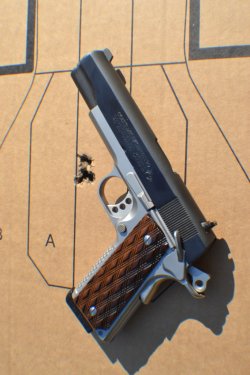

Here is a 25 yard group with Winchester Ranger +P 230 JHP - I built this gun for a customer and buit it as a carry gun, the barrel bushing is not particularly tight. The rear lockup is not loose however.
I will admit the slide on this one doesn't rattle ;) Yes I did have to move the rear sight after shooting this group .
