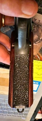

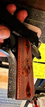

As promised. Bought the receiver like this. It was a 1958 Colt .38 Super that had been customized to .38 Special. Now it is a .45 ACP. Who stripled the grip is anyone guess. Whoever did it, did a very good job!

Another way to permanently texture a front of the grip frame is called stippling. I got the special stippling punch from Brownells. I had an old aftermarket frame 1911 parts gun. I applied the stippling by hitting and bouncing the punch all over the front of the frame. Takes awhile to get full coverage by hand. Strike and bounce at random working your way down. Then you have the nonslip grip area that looks like either very rough sand blast maybe or some of the texture you see on plastic grips. I just re-parkerized the frame on the stove and that was it. I guess it is considered old school.

The front of the grip frame in Post#23 is stripling. There are a variety of methods to accomplish this procedure. Should have mentioned the process in my post.
