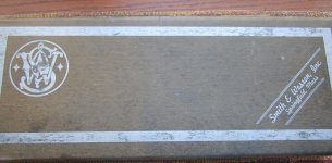

First off, the box is, or was blue. The only blue left is the bottom side walls. It looks brown with silver embossing and gray corners. Embossed on both sides as follows:
Smith & Wesson
1950 Model
44 Target Revolver
6 ½ Inch Barrel Blue finish

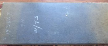

SN and TH in white grease pencil. W/TS, TS, TH in a slightly different white grease pencil.
In the box is a packing slip (express) and invoice from a LE equipment company in Berkeley to a LE guy in Placerville, dated mid July 1955.
Now for the strange part. The invoice says Target Hammer, Target Stocks. Unfortunately, the gun, with Target Stocks will not fit in the box which makes me think it was shipped from Springfield with magnas and the dealer installed targets as ordered by the customer
It's too bad this box is not numbered to my Model of 1950 from about one year earlier. Anyway it's a pretty cool box with some interesting provenance So I thought I would post this. I'll take some pictures of it in the morning.

I am curious also Ralph. I will not spring for a letter just to learn how it was originally shipped. Except for being sun bleached, the box is in pretty good condition. I'm fairly certain George F. Cakes Co. added the targets and mailed the gun and box to Assistant Chief Kiker with the gun NOT in the box because the gun will not fit with those stocks installed. I might contact Cakes Co. to see if they still have the original magnas. :rolleyes::D

I have seen a couple of Masterpieces that were built when Target Stocks first became available. They were shipped in the regular Gold Box with the grips detached from the gun and wrapped in brown tissue. They would simply write "TS" in black grease pencil on the end and the bottom. S&W quickly acquired some deeper/longer blue/black boxes that have 5 lug corners with NO printing so the guns could be shipped with Target grips attached. They labeled the boxes with the white descriptive labels which were probably printed in-house like Speedo2 shows above---
