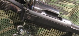

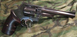

This professionally and tastefully done conversion from 357 to 44 Special really caught my eye. It has the bead blasted blue in all the right places (Highway Patrolman) with the non-serrated rear sight leaf. The real kicker for me is the recessed cylinder that fits the 44 Special rims perfectly. 44 Mag will not chamber. I added the Kim Ahrends that Kim custom made to fit my hand several years ago.
I have not done any cleaning on it yet and will post more pictures in better light when I do. For now, these will have to suffice. Now I can save my 1954 44 HE 4th Model Target (Pre-24) for looking and shoot this really cool revolver.
