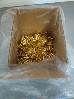

Ordered some Hornady 85 & 100 gr XTP to try along with a box of 75 gr Rimrock LFN bullets that I originally ordered for .32 acp. I'll be loading for a 432 UC, so I'm thinking a good place to start will be BE-86 using Unique load data to work up.
Let the games begin!View attachment 773395
