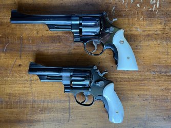

You may never know for sure who did the conversion. It should be a fun shooter and it oozes character! It appears to have the prewar long action, is it a prewar (WWII) or a postwar Heavy Duty?
I just looked at your original post, 4 line address is early post war, should have S prefix on serial number.
Took the Goodyears off and it looks like there was some pretty severe pitting.
Nice revolver. That pitting is one of the many reasons I just don't like Pach's
Thanks George!Don't mean to be a stickler, but it's actually.45 Colt not long Colt.
I try not to waste my time. Two year old threads would be a good example.This was a popular conversion 30 - 50 years ago. Virtually any gunsmith would do it, individuals would do it. I think you are wasting time trying to find who did it. Everyone would have.
I had a Rem UMC marked 45 colt that was shorter and probably designed for use in the S&W. It would also work in the Colt. Colt never really loaded a commercially loaded short colt so it's still called 45 Colt!I don't remember where I found this but it should be easy to locate the source, if you are interested.
Elmer Keith also wrote of a similar cartridge.
