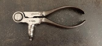

I recently found this at auction. The seller poorly listed it and did not know the caliber. I suspected it was a target tool so I bid on it and got it for a song.
The wife was wondering why I jumped up and down when I opened the package. The 38-44 Target tool is pretty rare. How rare? This is the first time I’ve had the opportunity to get one.
Cleaned it up and it has perfect deep stamp markings. I’m happy with the turn out.
What I’m wondering is if this tool is right? I have seen a 32-44 T without a bullet mold but never a 38-44T.
It doesn’t look to me like the mold block was removed but I’m not 100% on this one.
Anyone have one of these without the bullet mold?

Im new here my name is Stephen and im no good at the computer thing cant even find where to post but i did find this and just what i was looking for. I bought a antique 38-44 and would like some info about it please. Im in Nova Scotia canada i bought from Alberta was told it came out of drawer in Missouri and its a model 3 target 6.5 inch barrel it is in tip top shape for its age the serial is 2781. Any info would be greatly appreciated.
Ordered to customers spec’s
The more you study Ideal tools the more you see how many options the customer had. I thought the No.3 tool only came with double adjustable dies but looking at an 1894 ad you can see in photo 1 that the customer had the option of a single adjustable die as well.
I can also see the advantage. Saving $1 from purchasing the Target tool with the mold block ( photo 2) It makes sense to just save a buck on the No.3 tool and purchasing a separate insulated handle bullet mold in the same caliber for $1.25. That way the tool stays cool and you don’t burn your hands molding bullets. I’ve molded bullets with these tools and you have to use double insulated leather gloves and it still burns through.
Also, you can’t just go by what was advertised by Ideal in say 1895 as what was only available in any given Ideal tool.

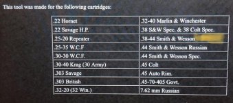

Photo 3 is from the Ideal collectors website. Notice many calibers listed and witnessed by collectors in the No.3 tool that is not listed in the 1895 ad. That includes the tool just presented by danalex. That caliber is not listed in 1895 but I’m sure it would have been manufactured for any customer who simply asked for it.
You figure it cost Ideal .50 cents to manufacture the tool. That’s a $2 profit for each sale. They would not let that customer just walk out of the office in 1895. $2 was a lot of money back then.
As a customer back then you could literally order anything you wanted from Ideal.
This also supports my researched theory that many of the tools were altered on site in the basement shop. In my opinion they had to be in order to make the sale. There is no way they had every variation of tool possible in the office for sale. Alterations would have been the norm.
My 38-44 example could actually have originally been a No.2 target tool that Ideal simply pulled off the wall and gave to the machinist in the basement with instructions to remove the mold block and polish. Same with danalex 44 Russian tool could have originally actually had a mold block but was ordered without and simply had an adjustable die machined and threaded onto the tool.
Murph

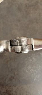

Late long frame?
Yote,
That looks like a late one with long frame. The cylinder length should be 1 9/16th. If it is a late one with long cylinder only a few hundred were made in the 38-44 T. I have one in my collection also.
I also see what looks like early London proofs on the cylinder and barrel. Can you confirm it’s proofed?
The early proofs look like an X with little flags kinda. Should also be some stamped on the frame and every cylinder flute. You might need a magnifying glass to see them cuz they are pretty small.
I’m seeing high domed screws typical of an England shipped gun.
They would re-work them and proof fire them to their particulars.
Nice and rare gun!

Better photo
Here is a photo of the proofs I think might be on your Target 38-44.
Murph

Thanks Murph for the great info, cant really see proof marks but it does have that cylinder size. I got a jewellers loupe somewhere i going to try to find it and have a better look in good light.
Not a 38 but a 32
