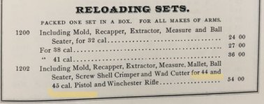

Also the photo of the catalog listing is for the older kit. I do not have any information on an IMPROVED KIT. It does prove however that the 1202 kit covered the 44 cal pistol.

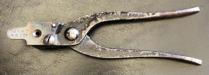

Mold
Here is the mold that accompanied this kit. Came out nice. It had a lot of rust on the block.
You can see it's the earlier RED HANDLED OUTSIDE LUBRICATED design that changed some time in the late 1880's- to early 1890's to a BLACK HANDLE INSIDE LUBRICATED BULLET.
The black handle is the improved bullet design so this may be a transitional kit. I've never seen a black handled 44 Russian mold but I have seen them in the 32&38 Smith & Wesson so obviously they do exist.

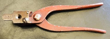

Black handle
Here is an example of a BLACK HANDLE BGI BULLET MOLD.
These are later molds that most often have later inside lubricated bullets.
There are NO ABSOLUTES when it comes to transitions. I believe most often it's the customer that is the root cause of oddities. Even though the Company has transitioned to a new bullet design the customer often makes the call. During that time satisfying the customer was monumental to your business surviving.
So the vast majority of black handled BGI MOLDS have the improved bullet.
