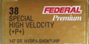

Yep.The 110s recoil less than the 125s, 147s, and 158s because of bullet weight.
I've not shot the 147 +P+. Would like to find some. Should be good in my 66 2.5", DW 2.something", and my Smith and Ruger 4" .357s.
Ought to be a good one for my 15-5 4".
