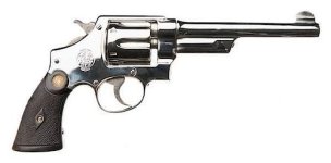

Today I stopped in my LGS to grab a few plastic boxes for my reloading. Looked over their used guns, and I see what I think is (maybe) a pre 1940 44 triple lock. Silly me, I left my phone in my car, and I was on a schedule to get a shopping trip done. Going back tomorrow to take a good look, and some pics.
Here's a generic pic of what I think I saw, and yes the one in the store was very good nickel, 6" (I think) and I could see the front of the cylinder. There were no burn marks from shooting. May be unfired, or meticlously cleaned. Don't know until tomorrow, like I said.
