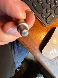

Wow! That's a ton of info and much to consider. To answer a few questions posed: 1. The overall length is 1.267. 2. Yes, cast lead bullets from Laser-Cast 200 grain, .452 diameter.. 3. Nick is on the tip of the lead.
It appears that the OAL may be too long. Additionally, pistol locked out of register and I could not rack it open or close. I forced it closed and then it would not rack open. I fired the round and it ejected normally.

That being said, 1.267" OAL for a 200 grain cast LSWC in 45 ACP is too long. 1.235" to 1.245" is the typical OAL for this bullet. Seating the bullets deeper into the case will raise operating pressure, so if these loads are already at or near maximum safe pressure, I would not advise doing so.

How much of the front driving band is sticking out of the cartridge case mouth? I have seen this happen several times. barrels with a long lead can be a problem if the bullet engages the taper before full battery is achieved. Those shooting "blue" bullets in Glocks "run and gun" where a bunch of rounds are fired rapidly. The chamber heats up enough to melt the blue paint, when the barrel cools, the bullet is glued into the barrel lead thus locking up the action. Seating the bullets in the case .010 deeper usually fixes the issue.
