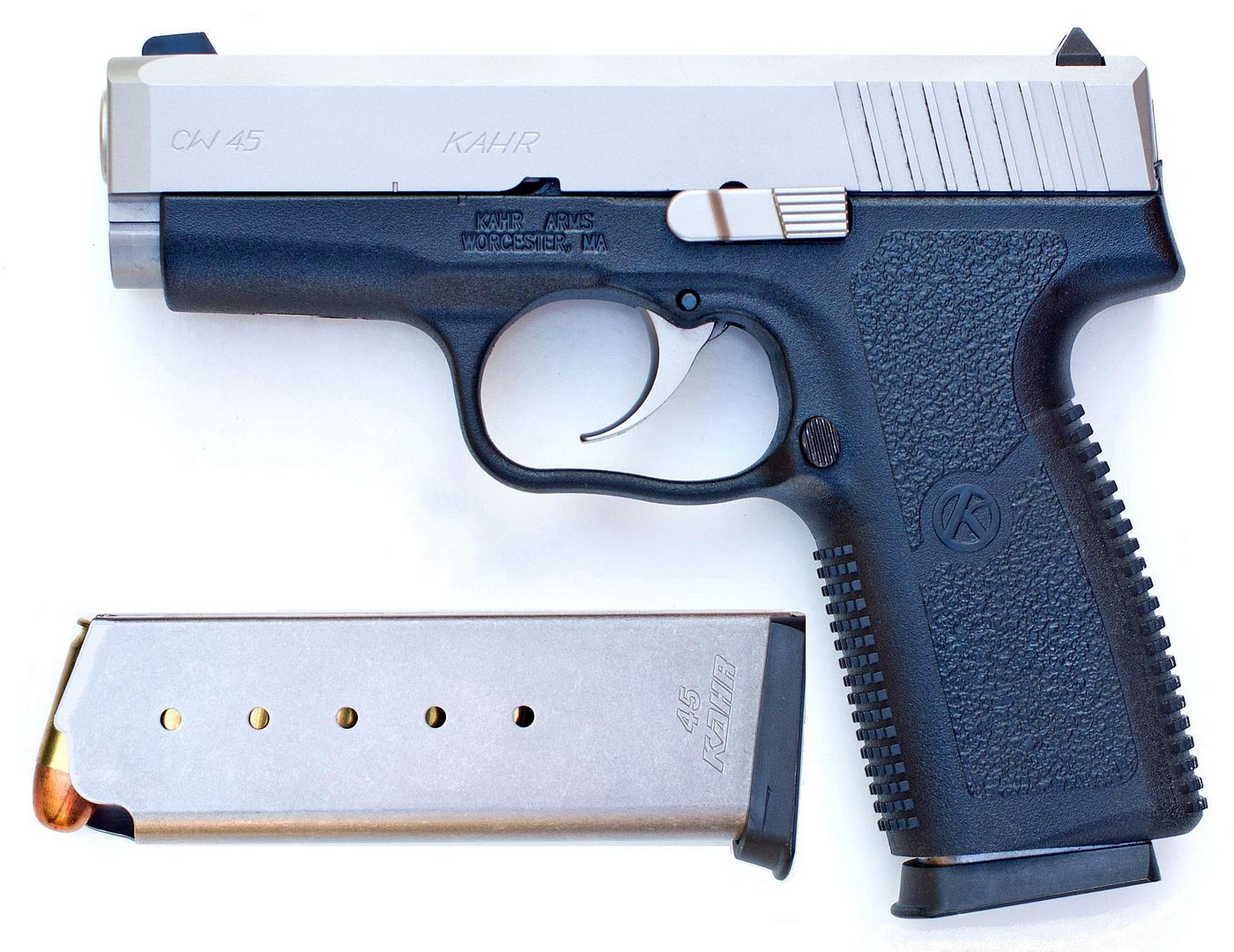

The Kahr CW 45 may be up your alley. Very light, easy to conceal, smooth DA trigger, quite reliable. No hammer, but this is more of a belly gun.
John
