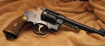

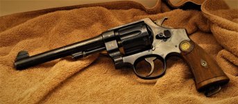

Just got picked this one up from the FFL after winning it on Gunbroker.
Surprisingly good shape for a 100 year old military gun.
White paint in cross pennants and other markings on left side.
Small dings here and there but overall pretty nice. Bore is mirror and recoil shield rest of gun show very little use. Chambers are perfect and still in 455 chambering. Has H OLIVER SEAL nicely stamped on bottom of right stock. Net search revels nothing on such a person.
Need to get a shell holder and some 455 brass I guess. My 455 triple lock has been reamed and recessed for 45 colt, but should still fire the 455 also.
I recommend straight acetone and a brush ... ;)
Seriously, I asked Richard Milner at the Webley Research Service in Britain about this, and he told me any white paint in British military markings is post-service applied and unhistoric, and can safely be removed.
Another thing I wonder about on this one is the seller was in Alaska. Have to wonder how it got there. Possibly it was in Canada as no Not British made stamped on it anywhere. and only marks other than the cross pennants and in and out arrows are cross pennants on back of cylinder and some kind of proofs by top of hump on left side. My 455 triplelock has Not British made and all kinds of stamping all over it and every chamber is proof marked. The British were very proud of their ability to make and use stamps. LOL
LOL, yes they were!
That's a spectacular 455 example! As original as they come and nicer condition than 98% of those that turn up.
No refinish, not monkeyed with, and the sideplate screws look un-turned since leaving Springfield.

That's a very nice one indeed. I can't make out the column of markings near the hump, but they are always acceptance and ownership markings along these lines:
Broad Arrow ... Accepted into British Military Service
Crown / F 7 / E ... Inspected and accepted into service at the Royal Small Arms Factory in Enfield, by Inspector F 7 (or whatever letter / number is on yours)
II ... This was the Mark II (second version) of the S&W .455, the first being the renowned "Triple Lock"
Of course, the crossed pennants are a proof mark. The point to point Broad Arrows show it was sold out of service on the civilian market. Yours also has the ".455" designation. Many did not have this since it would be assumed it fired the service round.
.455 Mark II brass is 0.77 " in length. I usually think of Mark I as being 0.88" but I have seen shorter lengths listed. These were chambered to fire the longer Mk I round and of course can fire the shorter Mk II as well.
Amazing that the chambers and (I hope!) bore are in such good condition. The WWI .455 Marks I & II were corrosive and erosive as hell.
