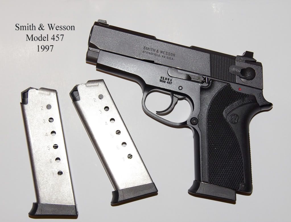

I just recently got one off of GB. Love it. I'm having mag issues, however. It came with what I believe is a non-SW magazine. 7 round, orange follower, works fine. I bought two new Pro-Mag magazines and they won't function most of the time. I've purchased a factory mag off of a site that shall remain nameless and I'm hoping this one will at least give me a reliable second magazine.
Has anyone else had any finicky magazine issues?

How many mags come with it? They’re nearly impossible to find.
Two, which was a pleasant surprise. I priced mags before I bought this. Pricey devils.
3-4 years ago, you could find those for $30-35.00, but now they are going for closer to $70.00. If you can find them.
There's 20 or so on ebay right now. None are a bargain. I think two will suit me fine.
Stay with SW OE mags as others have said. The OE 457 (1996-2006) mags are the same as the late 4516 / 4513TSW mags with black followers and are marked ES1 on forward face.
Due to some early problems with the 4516 feed using original mags, the early 4516 (1988-89) mags with orange follower were replaced by the 4516-1 (1989-1992) mags with yellow follower and finally the 4516-2 (1993-97 and 457 etc) mags with the black follower. Changes were also made to 4516 pistols including frame, guide rod, and barrel hence the -1 and -2 designations.
The last mags with the black follower and ES1 markings would have been OE to the 457 but earlier 4516 mags may work - just stay away from non SW mags.
