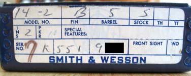

I have shown my 5 inch Model 14-2 before but here it is again. It shipped in a batch of 24 identical revolvers to a hardware distributor in Long Beach CA on 1/13/64. The factory letter calls it a "special production barrel length order". The end label indicates that it shipped with service stocks (Magnas) but the Diamond Target Stocks were on the gun when I bought it so I can't complain.
As others have commented, it handles very differently from a standard 6" K-38 Masterpiece. In fact I think it is perfect and the fact that they weren't a regular production barrel length option is puzzling. The same for a 5" barrel on the N Frame target sighted guns like the Model 29, 57 or even the Model 25-2.
