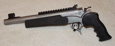

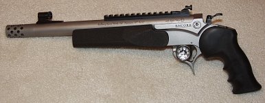

If you get a muzzle brake for that T/C barrel, I recommend getting one that you can take off.
This way you can shoot both with and without it.
You will not believe how much louder a brake can be especially in the larger cartridges.
Not too friendly at the indoor range (although I have done it when alone).
I wear both foam AND ear muffs.
