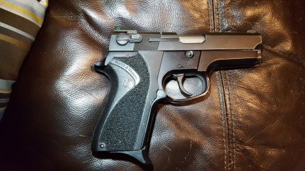

I do find the plastic grips a bit slippery. You can stipple the factory grips with a soldering iron and really improve the grip.

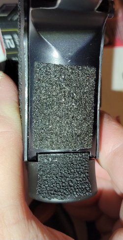

I also added a piece of tread tape to the front of the grip to enhance grip. I used this tape on the front of a 6904 that only had vertical lines, not the typical cross hatch grooves on it. I bought the tread tape from Lowes years back to put on my motorcycle floor board replacing rubber and it has held up for 25 years.
Cut to fit.
Rosewood
